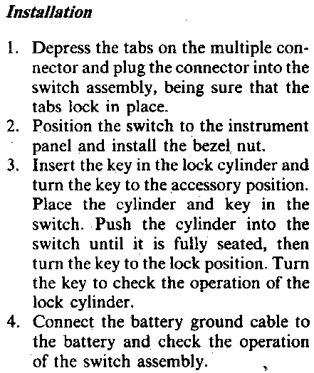

'Afternoon Ryan,
I took a closer look, and it appears that only a small subset of those two pages pertains to installing an ignition switch in F-series trucks! Here's that section from page 33-71-2 of the Ford, 1972 Truck Shop Manual:
Robroy
