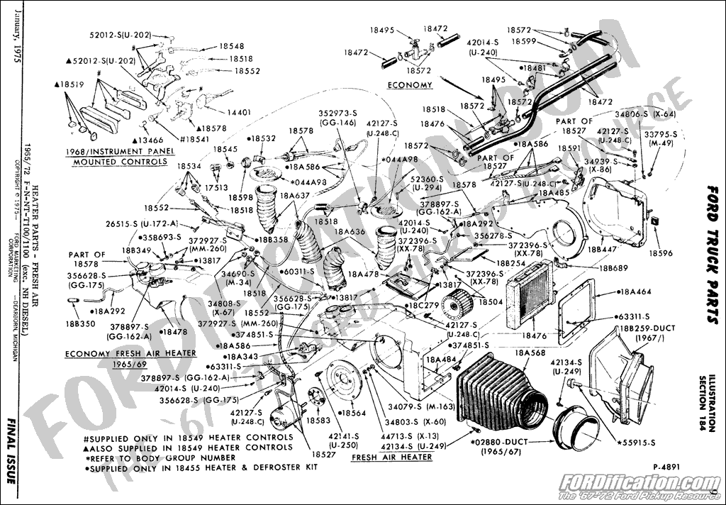

the only thing i could find is this. http://www.fordification.com/tech/image ... sh-air.gif
this is for the freash air heaters and not the deluxe heater with the three knobs. and this isnt a very good diagram as far as i am concerned. i don't have my 67 here. so i cant tell you exactly what cable goes to what. but it will be similar to the 68-72 deluxe heater cable arrangement. but i dont have one of those to look at. here is a picture that doesnt help much of the 68-72 heater controls hooked to the heater box.

Is the heater in the 67 the same heater as the 68-72 or did they change the box aswell as the heater controls?
- 100% FORDified!
- Posts: 22330
- Joined: Sun Aug 28, 2005 8:17 pm
- Location: Kansas, Ottawa
- Contact:
Re: dash controls in 1967 f100
the boxes are the same 67-72. its the fresh air vs deluxe heat that is the difference. and i think the only difference is the controls and the rubber boot. i think. there is a recent thread with soem pictures in it of the fresh air heater. but i can't remember what the thread was called. i'll see if i can find it.
