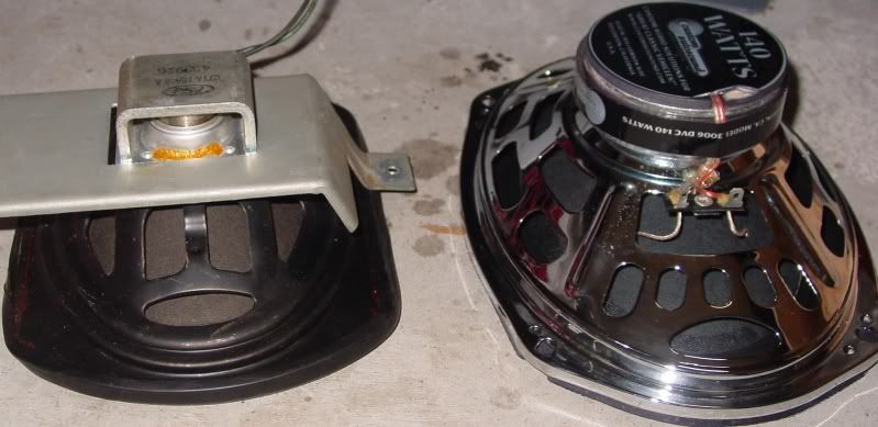

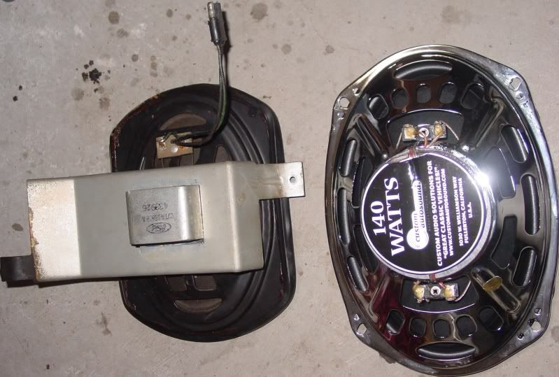

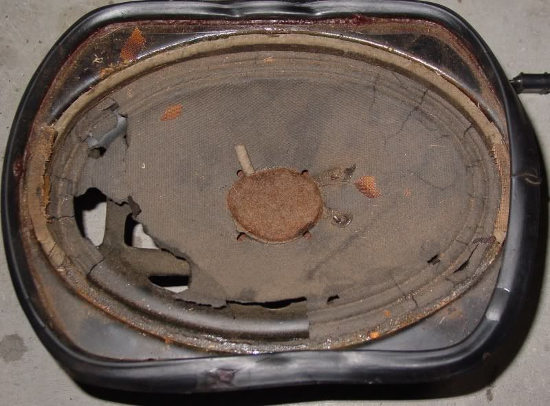

Good thing I read this post since i also bought the LMC speaker thinking it would be a direct replacement - wrong! See pics:

390bump wrote:Good thing I read this post since i also bought the LMC speaker thinking it would be a direct replacement - wrong! See pics:
[ Image ]
[ Image ]
[ Image ]

welll the lmc catalog description could be considered deseptive. "looks like the original" doesnt mean fits like the original. however the picture in the catalog is of the picture you posted with a round magnet. there is no way a large round peg will fit in a small square hole.

Those pictures definitely tell the story. I didn't really expect it to fit in the stock bracket (don't have one anyway), but I did expect that it would physically fit in the right location.
It looks like a great product. Seems to be well made. And it may fit fine in other old cars, but not a bumpside.
