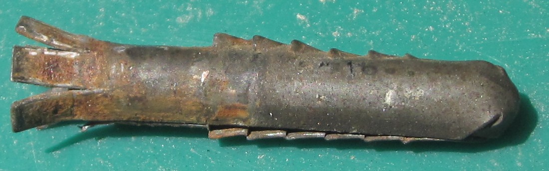

Here's what those firewall pad retainers look like:
First of all, there's virtually NO way of removing these retainers and keeping them in good enough condition to re-use. Plan on destroying them. Grab them with a pair of pliers where they poke through the engine bay and crush them. Being a smaller diameter now, the barbs along the side will easily fit through the hole in the firewall.

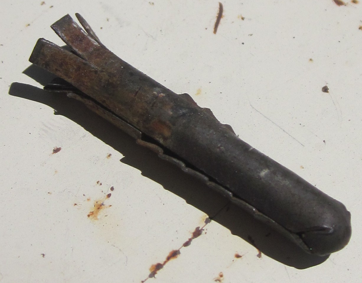

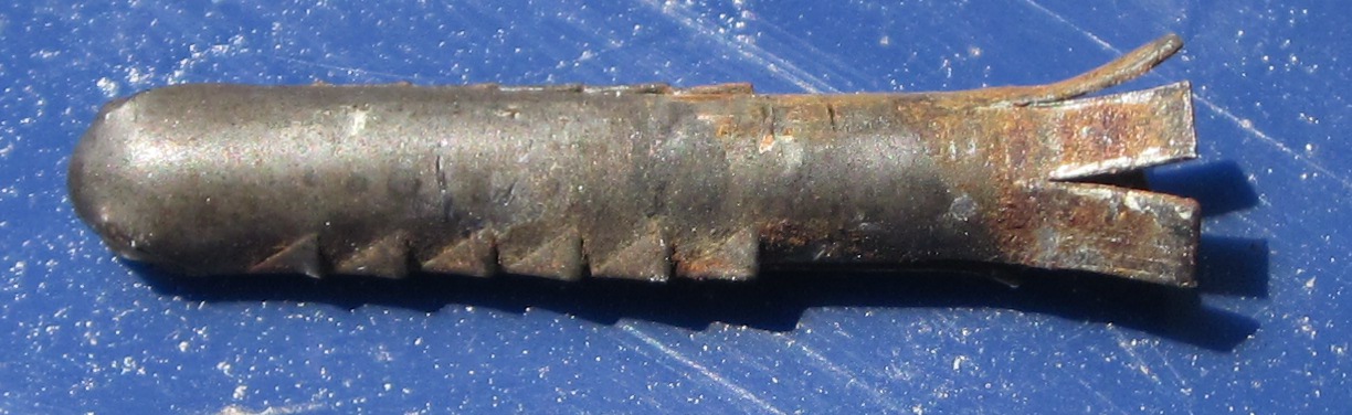

I think Keith's photo of the retainer's a lot better than these, especially since he's showing a complete, undamaged part.
Yet just by coincidence, this last weekend I removed one of these. I wanted to be able to lift the pad up a little to tuck a new floor mat under it, and I wasn't getting enough room under there with the retainer in place, so out it came.
My extraction method was effective but might have been a lot more difficult than it needed to be. First, I used my air-powered rotary tool with a cut-off wheel to slice open the flat, round head of the retainer. Then I inserted a long, skinny punch in to the retainer, and hammered it through. This had to bend the flower-pedal-looking arms in to fit through the hole in the firewall, so it's not an approach I'd necessarily recommend. It sounds like Keith knows how to deal with these in a much more civilized way.
