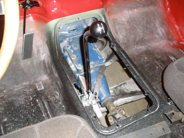

Managed to get a few days to work on the truck while I was home for Christmas. Here is a quick list of what we were able to get done:
-Installed rear window
-Installed brake, clutch, gas and parking brake pedals
-Installed master cylinder
-Installed steering column
-Installed new shifter
-Installed seats to final fit them with steering wheel
-Installed tailgate
-Installed clutch pivot/linkage assembly
-Finished bolting the bed down with new bolt set
-Installed door latch in drivers side door and exterior door handles on both
-Installed new side mirrors
-Installed FORD letters on hood
We ran into a couple issues...
Clutch spring - this is more of a question than an issue but thought someone could help. We installed the rods and pivots for the clutch pedal. In the diagram it looks like there is supposed to be a spring on the fork coming out of the transmission and there is a hole for it. The issue is that I don't know where the spring would attach to, it is a pretty long spring and I didn't see where it went. Anyone have any pictures of this spring for a 3-speed transmission?
Steering column - when we started the project we had a 67 cab with a manual transmission but had a steering column with an automatic shifter for some reason. The new cab we ended up getting was I think a 71 camper special that must of had power steering with the longer steering box. We rebuilt and went to install the column from that cab and the mount didn't line up I think because our manual steering box being shorter. We ended up just adding a bracket to hold the column in place. Not a big deal just looks a little weird because we kept the old bracket on there too. Might fix this later.
Doors - like I said the truck is a 67 but because the cab was in rough shape we found a 71 cab that we are using. We also bought from the same guy a set of doors. I also assumed these were the same year, 71. Turns out one of the replacement doors was in poor shape so I bought another replacement before the truck was painted that was a non-67 door to match the other. I went to install the latch in one of the doors though this weekend and realized it is a 67 door. This was the door we had bought with the new cab so not sure why he had a 71 cab and 67 doors. Long story short, our doors don't match. Not sure what I can do at this point. I have a new door panel set from LMC for the 68-72 cab so I will install that on the passenger side and then paint the metal 67 door panel black to match on the drivers side.
Sorry for that long post but wanted to go through some of what we went through during the weekend....here comes the pictures.

Great progress and looking great! As for the clutch spring, I bought a spring with a long straight end and just bent a hook in the end and hooked it in the front crossmember. In the right center of this diagram vaguely shows the location to hook the spring. http://www.fordification.com/tech/image ... dals02.jpg

Great work on truck! I like the floor shift mod. Looks like you have the same trans i have. I would like to know the info on the shifter such as part # and the ease of installation. Don't forget to post a pick of interior when done. Again, the project looks really great :thup:
