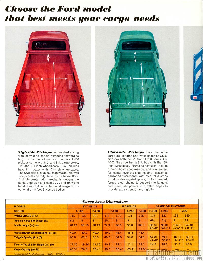

Here is some info on the flareside boxes, the first one is from the factory library, and the 2nd is from the 1970 body builders info.
http://www.fordification.com/library/up ... f25c40.jpg
http://www.fordification.com/tech/images/bb70/p144.jpg
Regards :thup:

looks like you would need to shorten the length,width and height. Thanks for the reply.

If you're worried about the "correct police".
otherwise with some careful measuring , cutting and welding it is doable to shorten it.
you can also buy" new" repo bed parts.
